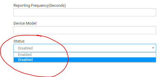

UP........desperately needed feature, I have seeing it  in other platforms, a simple activate check mark suspends the unit from the client and stops the charge to us dealers.

Frequently a client pauses the service for different reasons, only to activate again later, so if we don't want to be charged by Wialon, we must delete this device, when the client calls and request we resume service, now we have to enter the information of the device again. a total waste of time, it would be so much simple to have a status check mark where you can choose enabled/disable as the picture below. When enabled we get charged and disable we don't, in the disable mode of course the device dos not store any new data.
