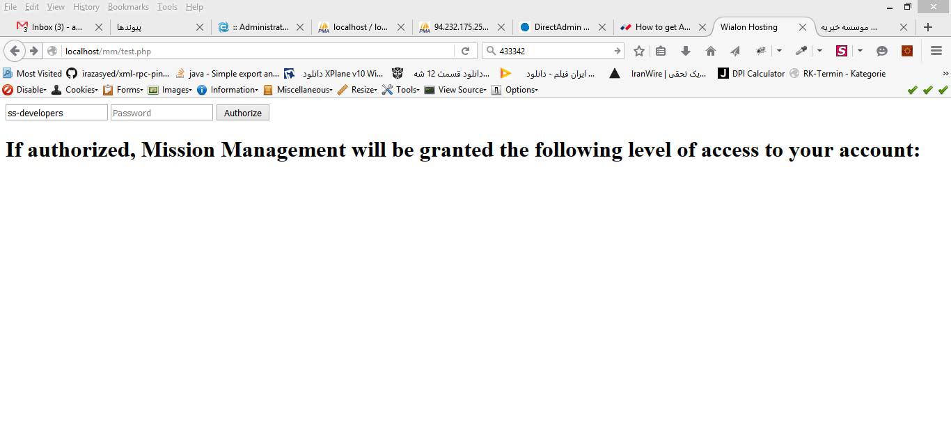

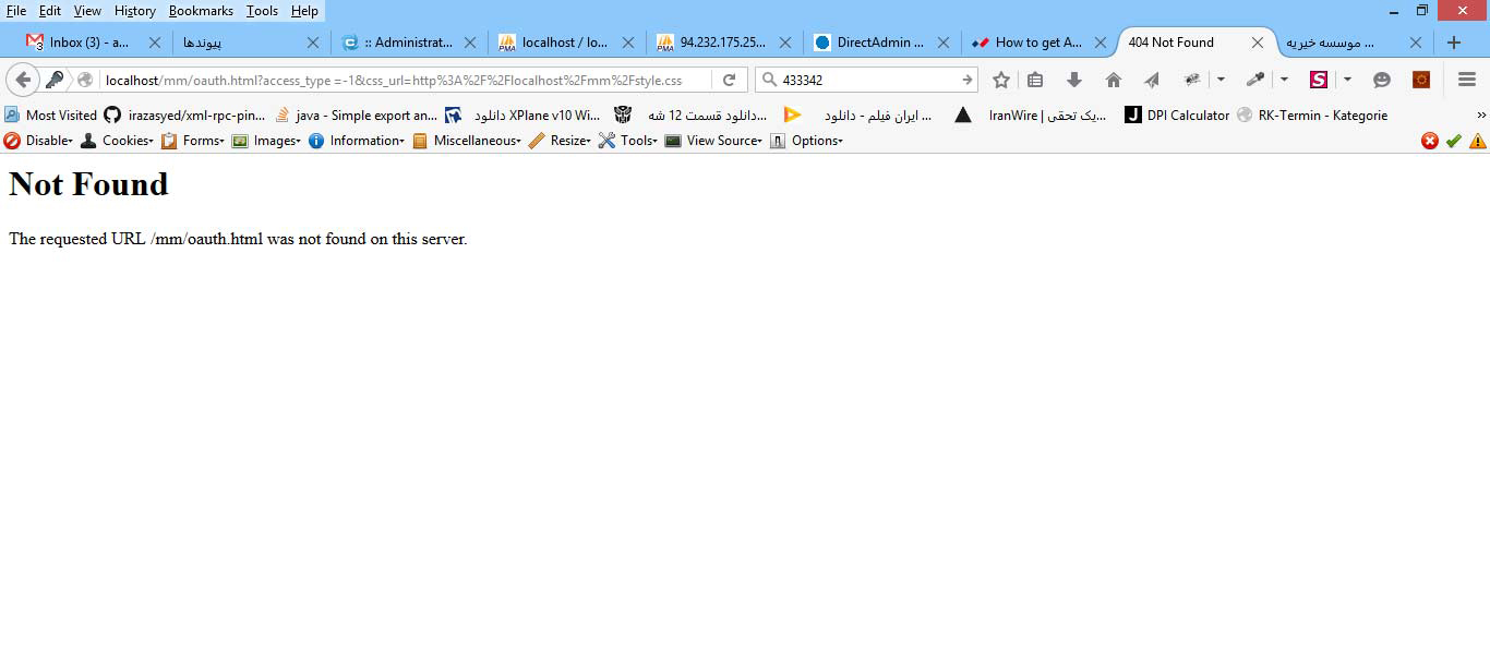

Dear deal
We are working on PHP, the code we use is as below:
<?php
// Define URL where the form resides
$form_url = "http://hosting.wialon.com/login.html";
// This is the data to POST to the form. The KEY of the array is the name of the field. The value is the value posted.
$data_to_post = array();
$data_to_post['client_id'] = "Mission Management";
$data_to_post['access_type '] = "-1";
$data_to_post['activation_time'] = "0";
$data_to_post['duration'] = "2592000";
$data_to_post['lang'] =  "en";
$data_to_post['flags'] = "0";
$data_to_post['user'] = 'ss-developers';
$data_to_post['redirect_uri'] = 'http://localhost/mm/main.php';
$data_to_post['response_type'] = 'token';
$data_to_post['css_url'] = 'http://localhost/mm/style.css';
// Initialize cURL
$curl = curl_init();
// Set the options
curl_setopt($curl,CURLOPT_URL, $form_url);
// This sets the number of fields to post
curl_setopt($curl,CURLOPT_POST, sizeof($data_to_post));
// This is the fields to post in the form of an array.
curl_setopt($curl,CURLOPT_POSTFIELDS, $data_to_post);
//execute the post
$result = curl_exec($curl);
//print_r ($result);
//close the connection
curl_close($curl);
we run this code on local host, the result is as attached screenshot "login.jpg" and after entering the username and password the result is as "error.jpg" attachment.
Please guide us, explain what's wrong.

hhamedk, You use our oauth form in wrong way - it won't work.
Тry to show form in separate window, like here http://sdk.wialon.com/playground/demo/app_auth_token
or in iframe, like here http://sdk.wialon.com/playground/uQRYKW7y/4
